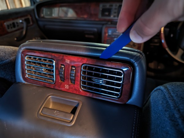

First up, remove the rear air vent panel. It's tempting to just remove the two silver air vents themselves, but it's quite hard to do that without breaking the interference washers that smooth the adjustment of the air vents (ask me how I know). So just pry the whole unit out. It's press-fit; there aren't any clips.

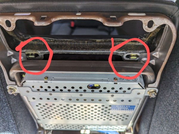

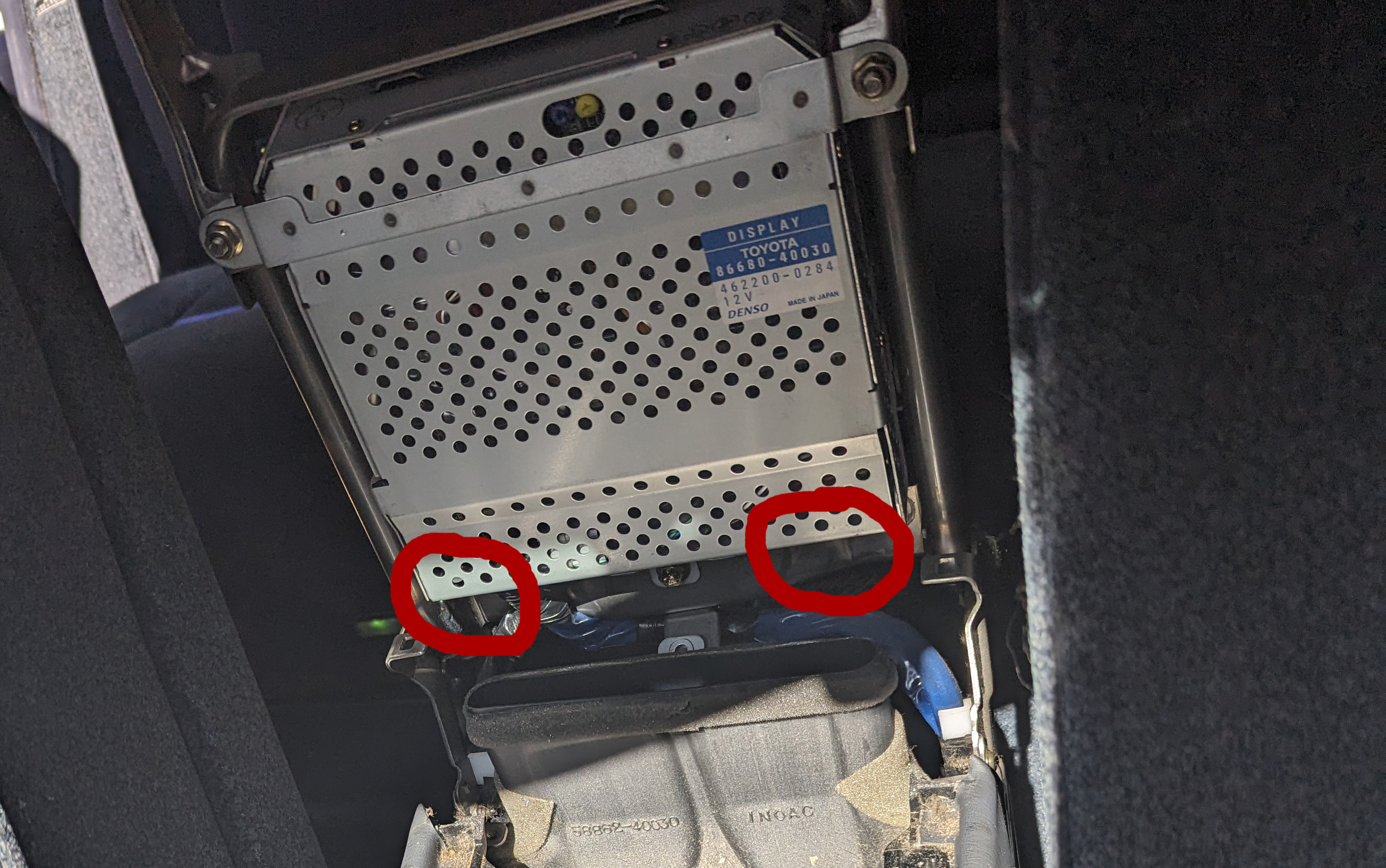

Remove the two 12mm brass bolts under the rear of the screen - these hold the tray table. Don't drop those down the HVAC either. I don't have a very good pic of those but they're roughly here:
