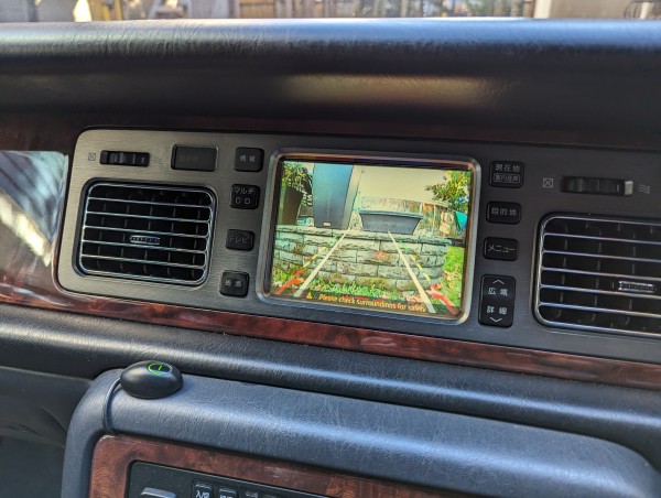

I was keen to add a backup camera and Android Auto support to my 1998 Century so that I could run Google Maps, Spotify, etc through my phone. Other people have done this by either mounting an extra screen in the car or using a TV modulator to feed a signal into the antenna in the boot/trunk. I wanted to leave the OEM screens and I didn't think that audio quality would be great through a TV modulator, so I instead decided to run my system through the car's built-in VCR connector.

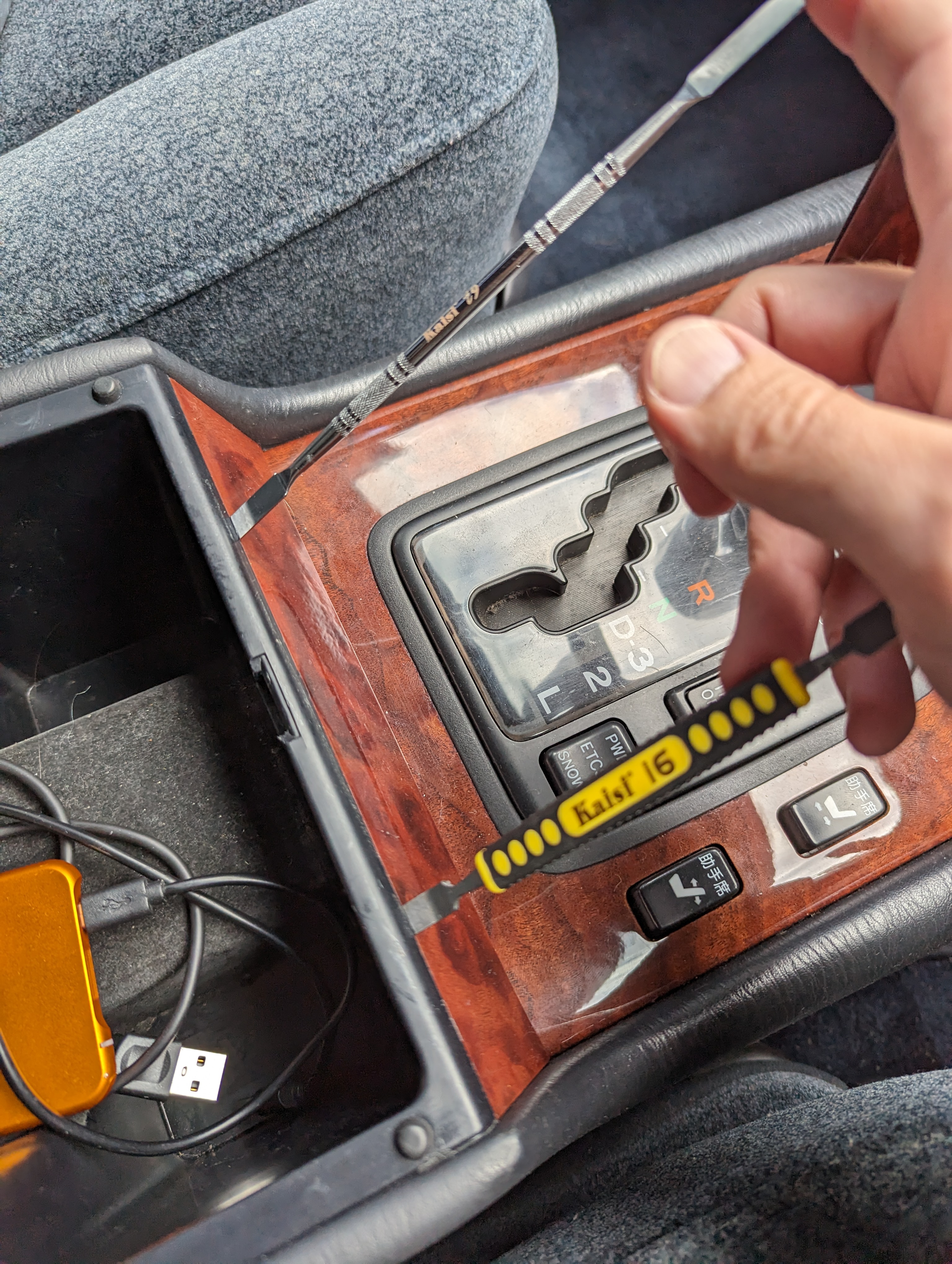

The VCR connects to the car via a wiring harness under the center console. To get to this:
  • Pry off the small woodgrain panel that sits between the lower center console and the cubby box. It's a lot less fragile than it looks but you should probably pry it from both sides at the same time. There are three clips holding it on at the left/right/centre.

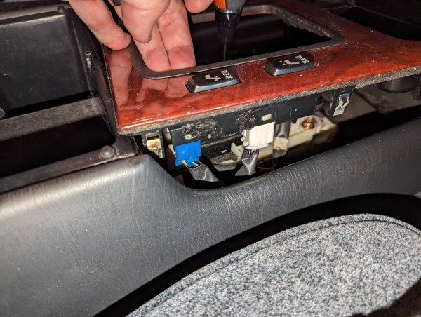

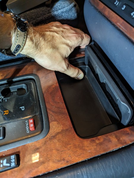

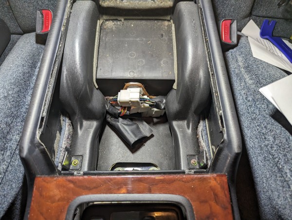

  • Unscrew the two screws that hold the plastic cubby box in there. The cubby box will then lift out - it tips towards the back of the car as it comes out. This will reveal the wiring harness - the lowest connector in this harness is the VCR (not connected in this pic).

This will enable your own video to be shown on the Century's rear screen whenever you switch to the VCR. If you want to show it on the front screen you can press the third button down on the left to mirror the rear screen. The car remembers this setting even after you switch it off, so you don't have to press it every time you start the car.

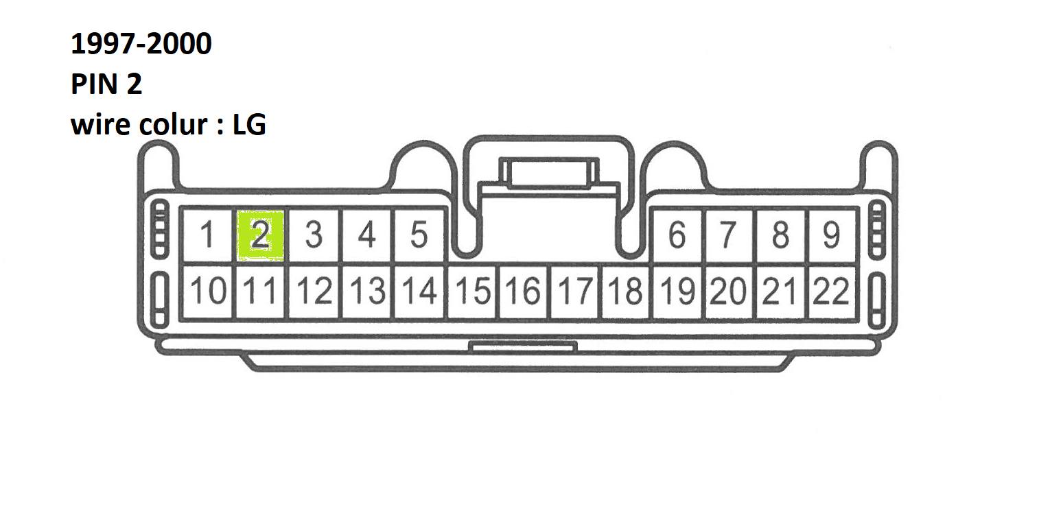

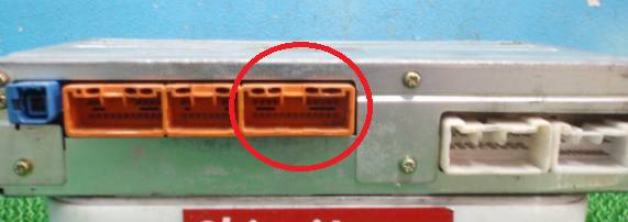

I just got one of the boxes on yahoo auctions after looking for a year they are no longer made and you cannot find any old stock in japan now. With that said you can short a pin to gorund to make the front screen display. Some time back I got a reply in the facebook group with the details Please see the attached photos.
I hope this helps and let me know if anyone has any questions.

brahoff wrote: Fri Mar 28, 2025 1:30 pm Thanks for sharing!
@Ghzhammer, is this image/pinout showing the TV kit box you got or one of the the modules from the car?
That was the pin out for the nav system in the car under the seat. The ttv-145 and ttn-135 are the switches for this as well but long gone in gen. I was very lucky to find one pulled out of a totaled car in japan. Let us know how the project is going as well I have some other insights for the system if you want to chat more about it.
