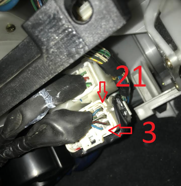

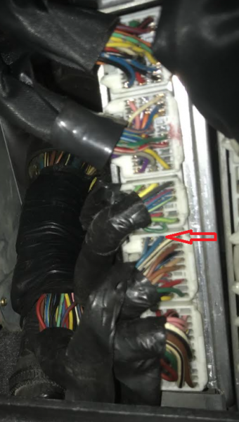

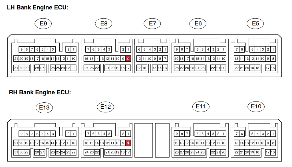

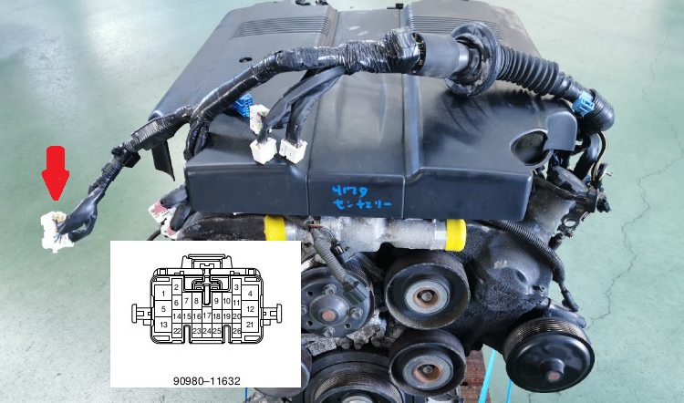

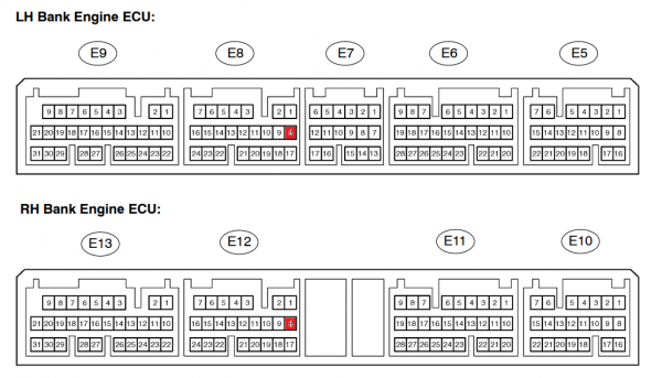

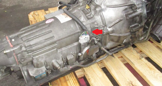

This wire will give 12+ on reverse gear
1) Connector IG2, from wiring its blue wire pin 3, 21
2) Connector IG1, pin 17 also blue wire
3) Direct from ECU pin, E8 pin8 or E12 pin8
4) Jump wire from the gearbox, trace the blue wire from there
IG1 and IG2 connector is somewhere near the ECU. need to take the glove box off first.
**just from the diagram please check the wire color matching**

-IG1
-IG2
-gearbox side
-IG2
-gearbox side
- Attachments
- *blue wire
- IG2 IG1.png (568.34 KiB) Viewed 94761 times
- *another blue wire
- R indicator.png (307.87 KiB) Viewed 94771 times

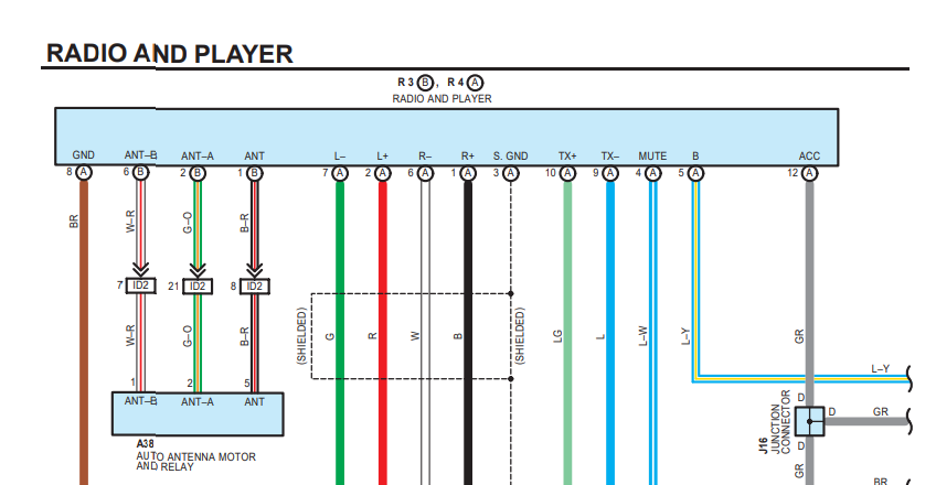

Re: Least-obtrusive way to get Android Auto/CarPlay in a GZG50 Century
Speaker
L+ L- R+ R-
wire color might be the same
L+ L- R+ R-

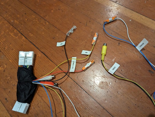

The good news: I've pretty much got Android Auto and the backup camera working in the car. I've made what I'm hoping is my final version of the VCR wiring harness extender. I'm hoping that tomorrow I'll be able to put all this stuff into the car and actually get my front console cubby box and cup holders back.
The bad news: I thought that the reason I could view my Android Auto output on the front screen while driving was because my car is an early car. However, while rooting around under the passenger seat, I discovered that my car has already been fitted with some sort of magic box which allows the front screen to view video while the car is driving. This means that the guide I'm going to write is not going to cover this part - I'm hoping that someone else might help here!

I basically got most of this working - I've got Android Auto on the original screen in the car, backup camera coming on when you engage reverse, and audio through the factory audio. I still don't have a touch screen (so it's voice control only) and the audio isn't perfect, but I'm pretty close!
Will post a build thread in the next few weeks with part numbers/links etc.
