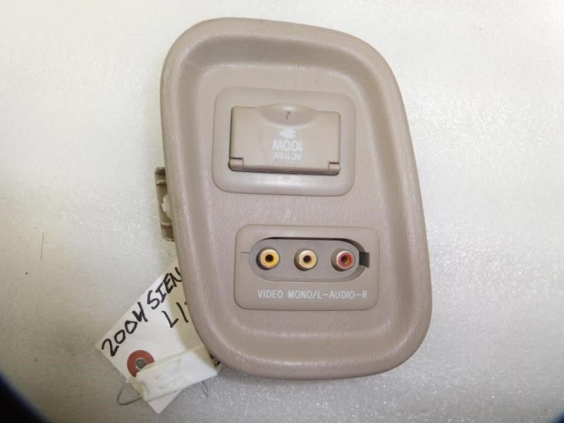

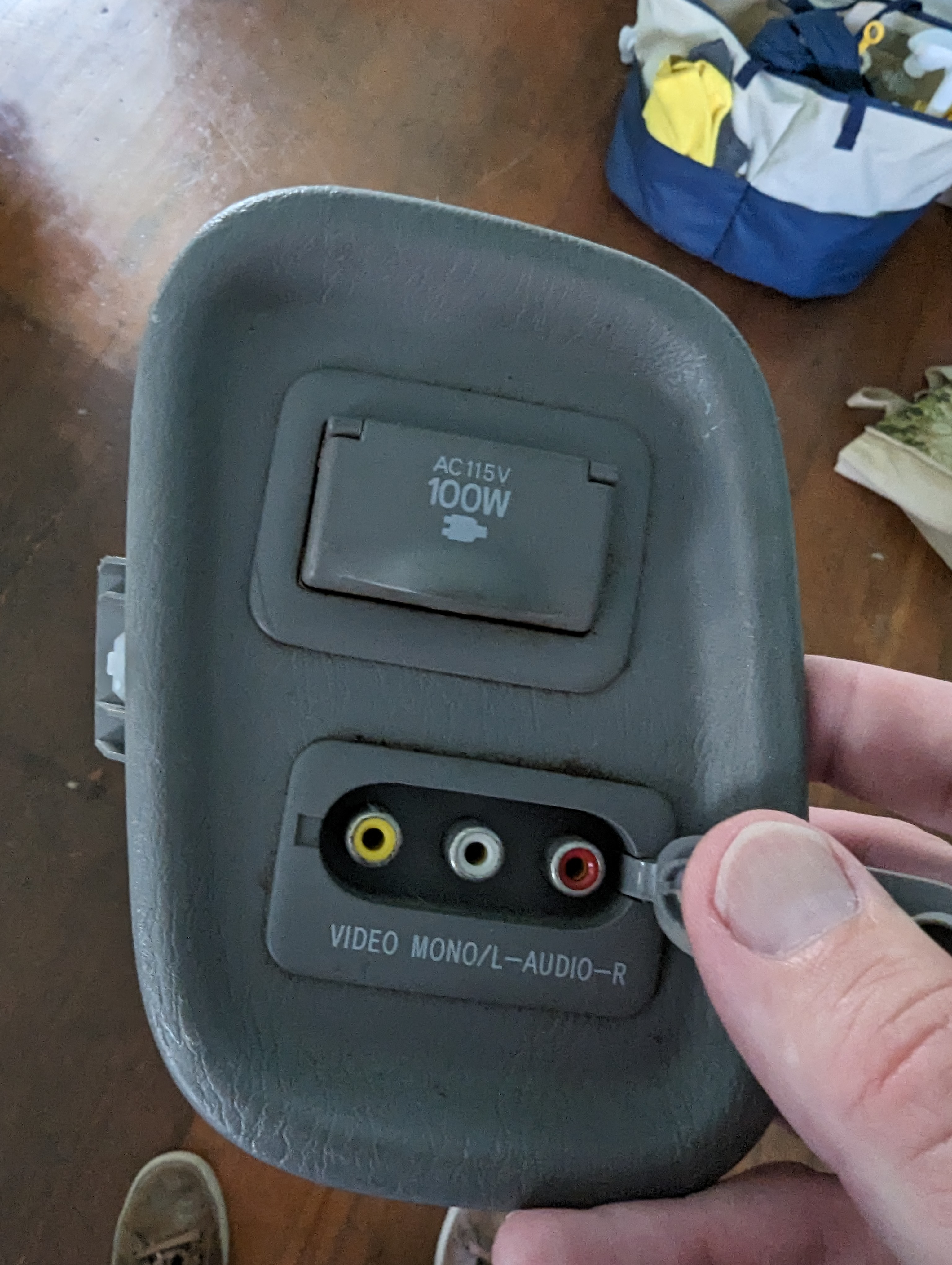

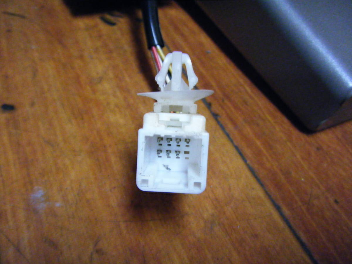

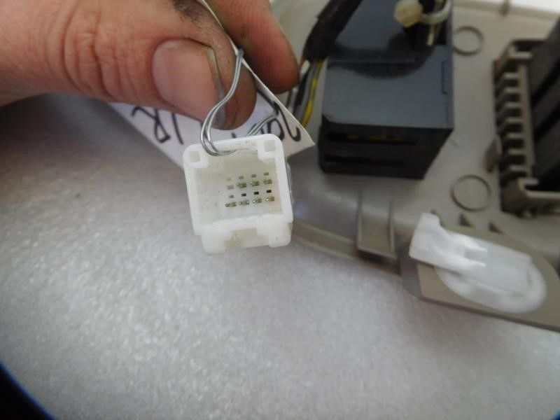

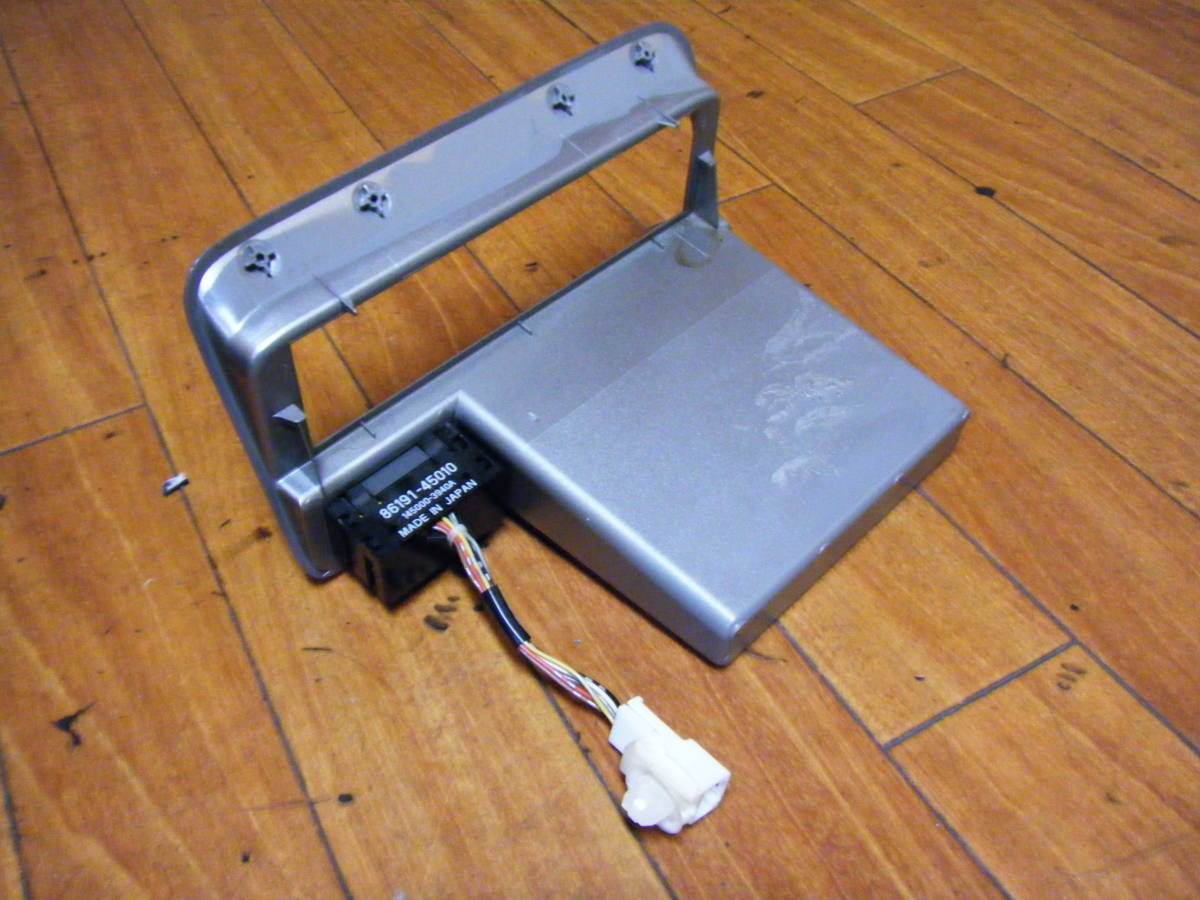

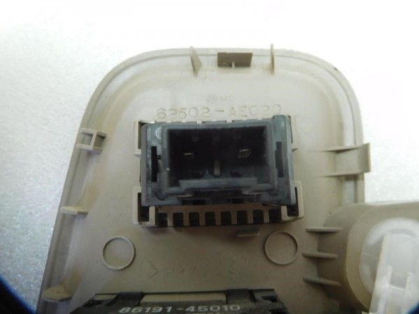

I've been thinking about how to put an external video input into the Century screen... I found these pictures of a Century DVD player. What's interesting about it is that the DVD player has the yellow/red/white photo connections in the front of it; I thought that if I could work out how those phono connections go into the Century's wiring harness then I could just splice another device in there instead of a DVD player.
From the photos you can see a part number on the phono connector (86191-45010). I'm going to see if I can find that part...

Did a bit more digging on this... this Toyota Sienna S-video connector looks a lot like it would fit into the Century harness. Part number is 86191-45010. You can get these pretty easily on eBay - e.g. https://www.ebay.com/sch/i.html?_from=R ... 0&_sacat=0

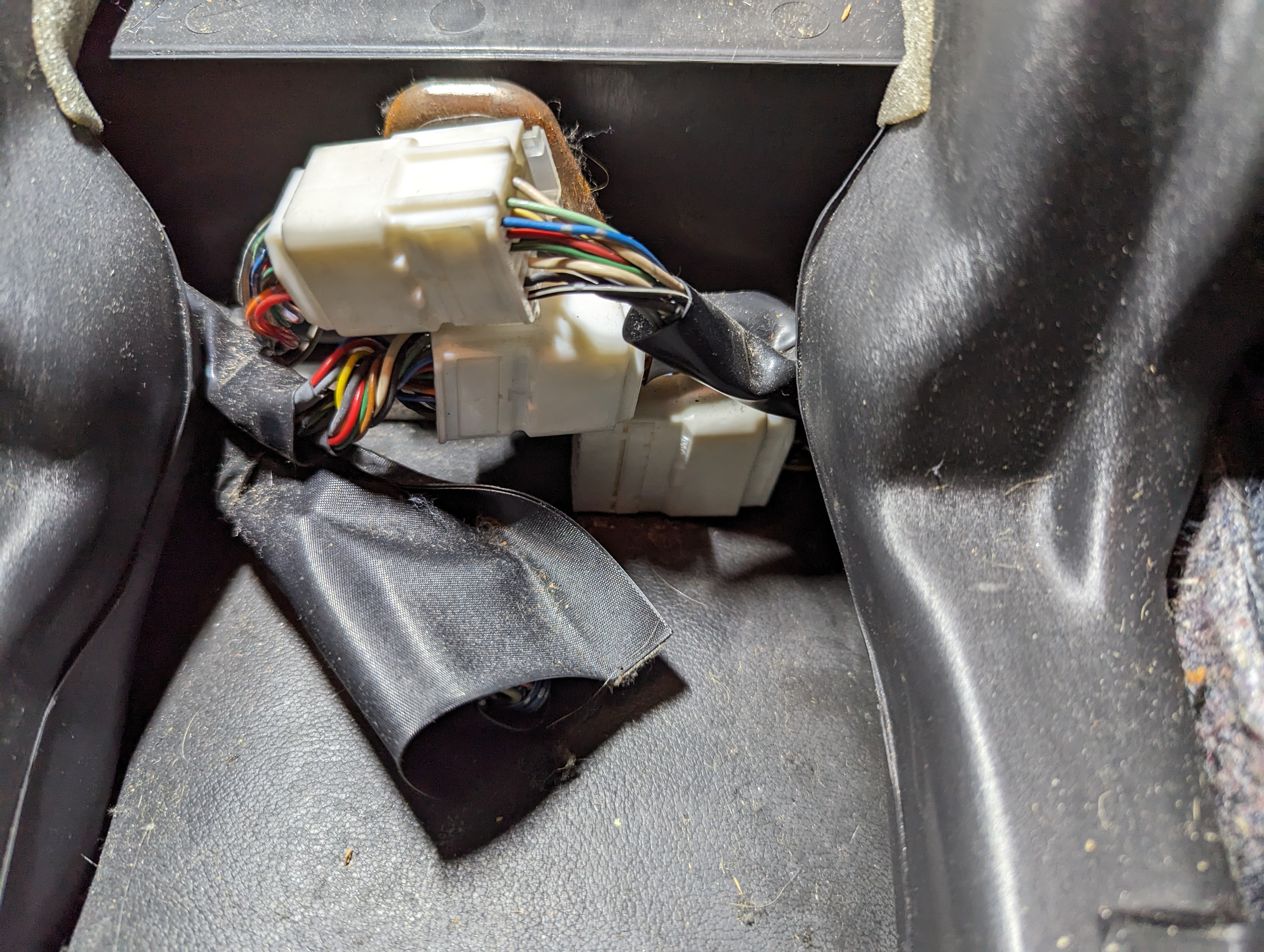

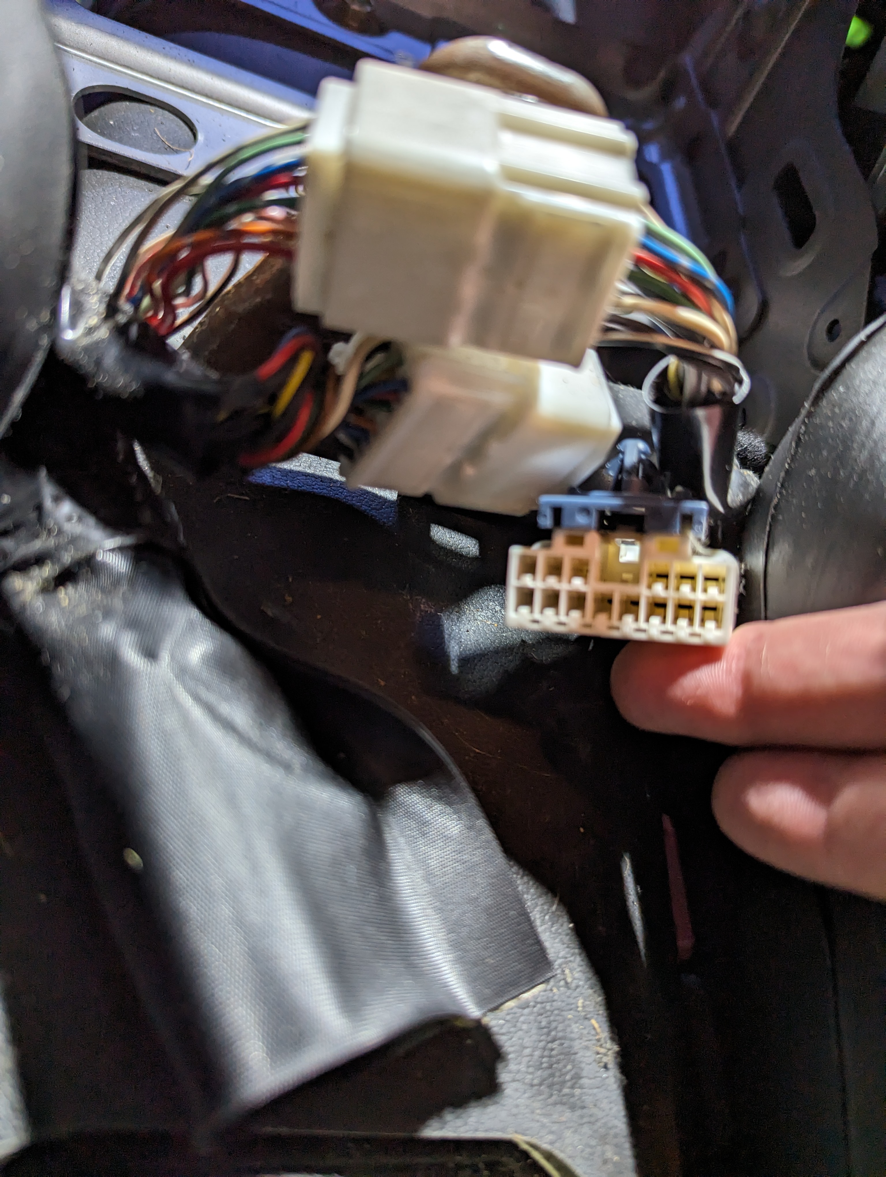

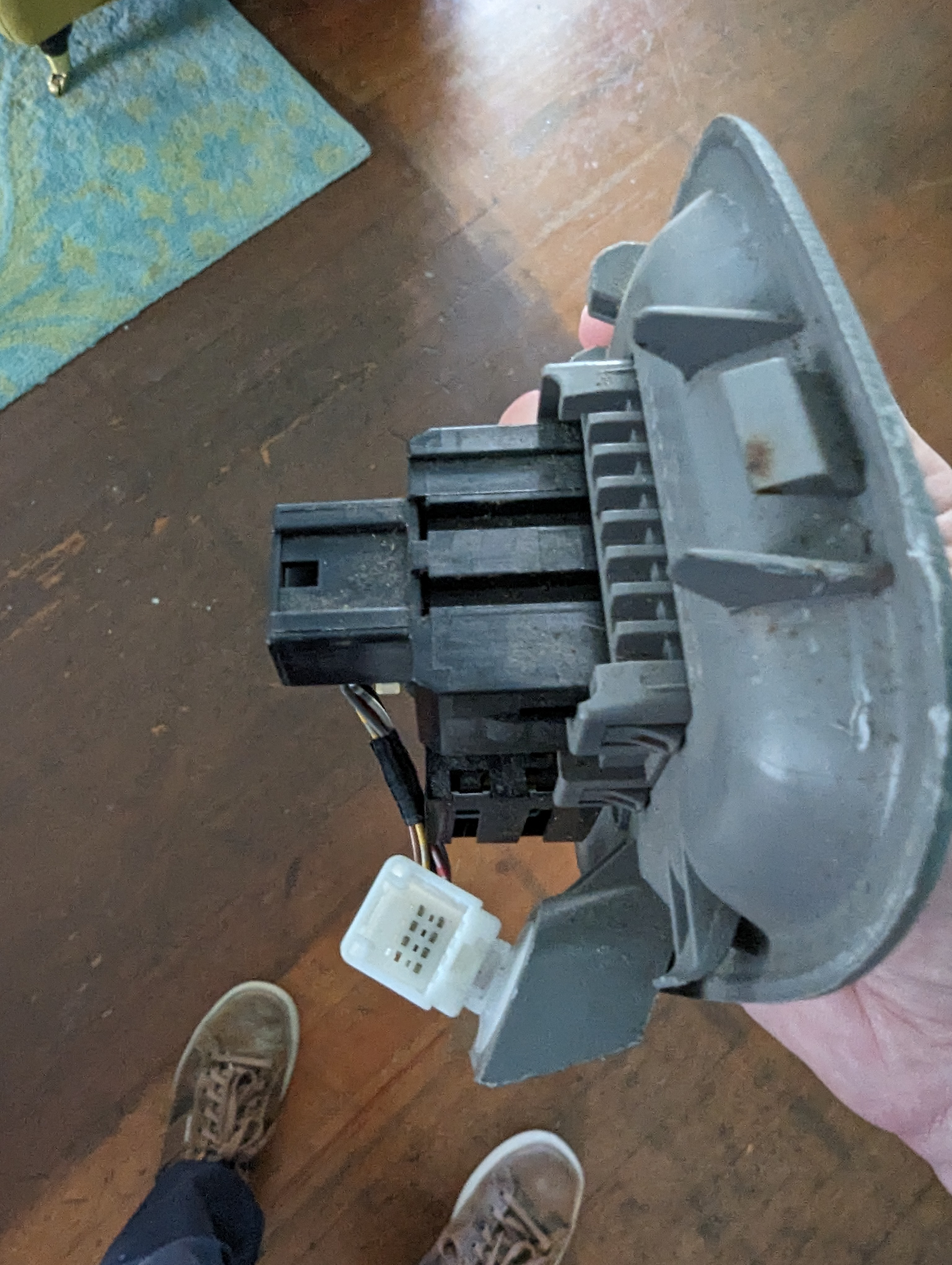

Well, I took apart the center console in the hope of finding the white block connector that my Sienna RCA inputs might connect to, but it looks like I'm having no luck. There is a big white block connector that isn't attached to anything, but it certainly isn't the same shape as the Sienna connector.
Re: Least-obtrusive way to get Android Auto/CarPlay in a GZG50 Century
The good news is that I managed to get the center console apart... the bad news is that there don't seem to be any connectors other than those three. This suggests to me that the VCR plugged into one of these, and not into anything like the connector I saw on the DVD player (perhaps this was only on more recent cars)?
Here's the only spare connector that was under the center console (it's sized for 16 pins but only has 14 pins used):

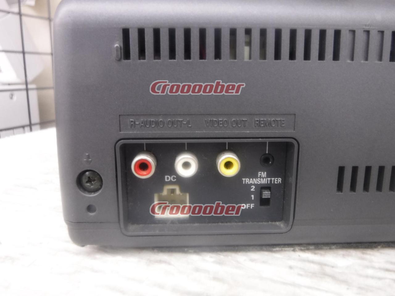

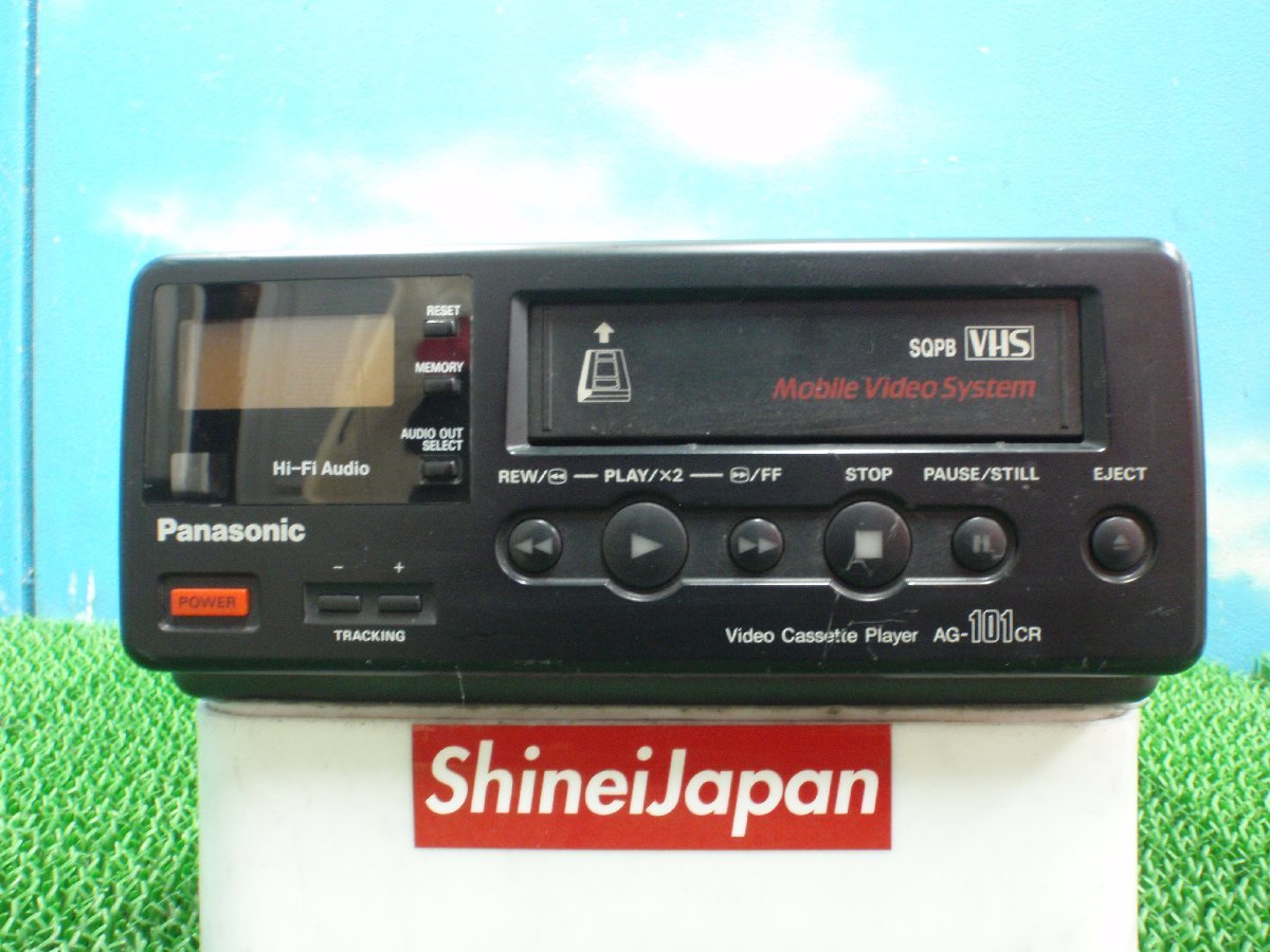

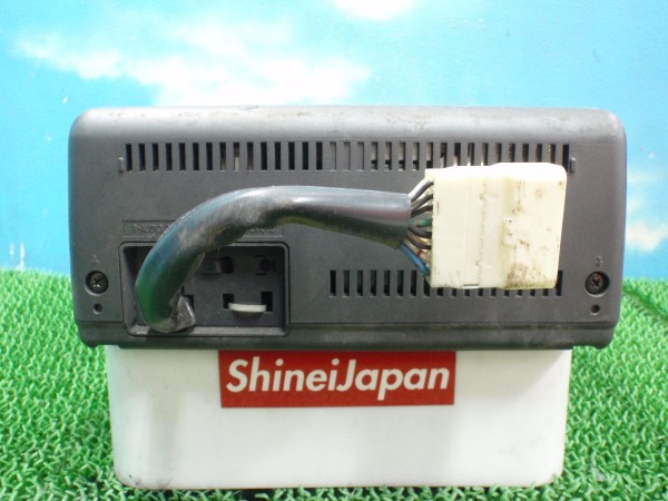

I did a bit of digging around and found an original VCR player for sale on Yahoo Japan (https://buyee.jp/item/yahoo/auction/t1091945045). The connector on that looks like it's 8 pins wide and would fit nicely into the female socket I've got:
Unfortunately there aren't any pics of the end of the connector so that's all a bit of a guess.
The pics for that auction do also show the model name for the VCR - it seems to be a Panasonic AG-101CR.
Further googling that VCR unit seems to suggest that it was available with normal RCA outputs on the back instead:
Continuing my general theme of wild conjecture here, I'm thinking maybe this means that three of the pins in the cable are in fact L/R audio and RCA video. I'm now wondering whether I try to procure a VCR unit and then try to derive what the outputs were. I suspect that there'll be more to it than this, as I bet there's also some sort of trigger for when the video player is actually playing something (to tell the car to put it on the screen).
