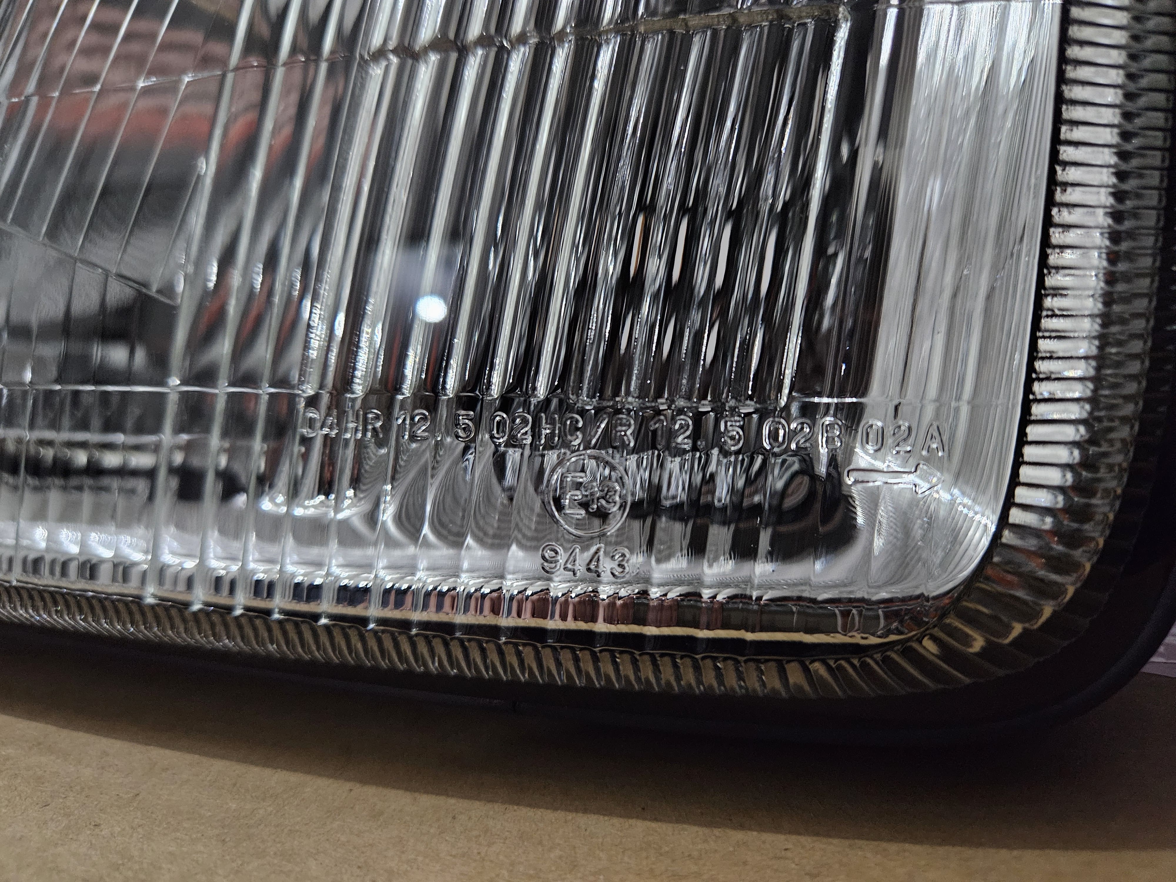

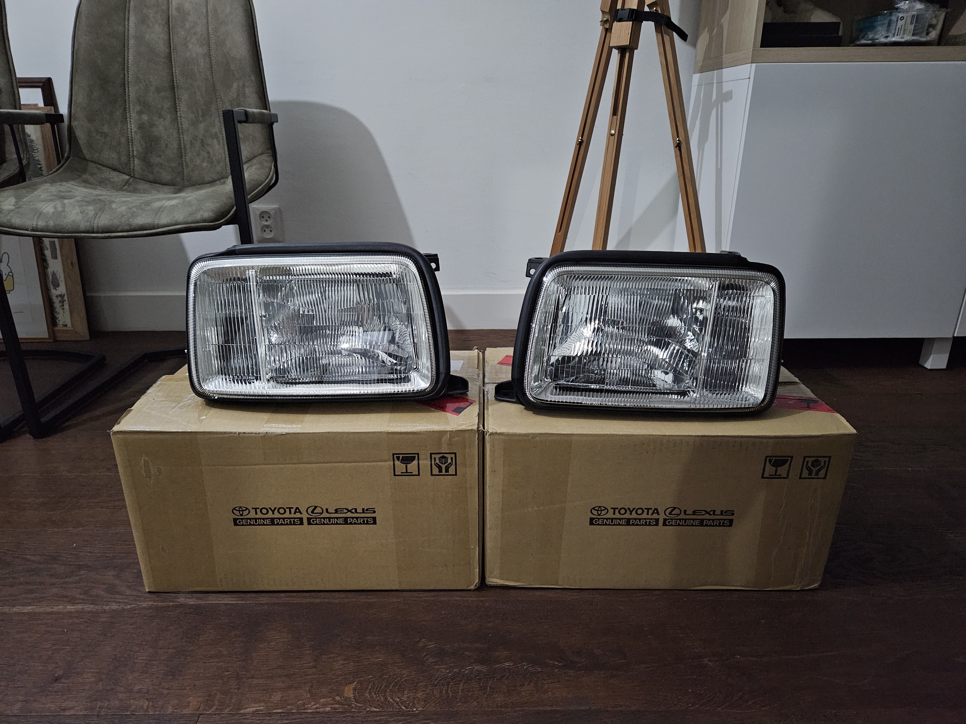

I've mailed a bunch of partshops around the world whether they had the LHD/European headlamps for sale, and only heard back from this one German shop https://www.online-teile.com/. They initially didn't have it in stock, but assured me they could deliver it if I placed an order.
Two weeks later and almost €1200 lighter, I received the LHD lamps! (part numbers 81170-40050 & 81130-40050)
E-Marking included
E-Marking included
My Century arrives in 2~3 weeks. I'll take a new picture once they're installed.
